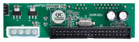

The IDE to SATA adapter looks similar to that.
Jumper seems to be on "Master" position (im am not able to read without removing the adapter from the computer), which is wrong if I read right.
After changing the position OS X booted at a similar time, OS 9 did not boot at all but stuck at the question mark. :(

One of the suggestions was: An issue with the IDE to SATA adapter.
So I ordered a StarTech IDE to SATA adapter (the red one).
The adapter just arrived.
After some testing I found out that jumper on "Master" and jumper on "ADC" worked for me.
Cube is now booting into OS 9 without question mark, booting into OS X is a little bit faster, CDROM is visible in System info, so I assume this work as well.
