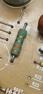

I am having the exact same issues states here. R726 is super hot that the board looks burnt, and R788 is completely burnt out. I’m not sure how I go about finding the values of these since the markings are no longer legible. Any suggestions? It let out the magic smoke after I moved the SW701 switch to the upright position (can be seen to the right of the flyback in photos). It wasn’t giving a picture before I did this either though. I’d really like to get this machine up and running! I have not replaced anything yet.IMG_5531.jpegIMG_5532.jpeg
I don't have any more ideas on how to troubleshoot this, but I have a partially disassembled AIO that I can get those resistor values from for you. Do you have any idea what SW701 is supposed to do?
Edit: Found this in the 5400 service manual. The board must be close enough to the same that some of the component labels match up:
Switch SW701 has three positions. You can control the horizontal centering of the display either by using SW701 together with the horizontal shift control (VR701) or by using VR701 alone.
Based on that, I don't think that moving SW701 was related to burning up those resistors.
Hey, you beat me to it. Thanks. So R726 is 3.3Ω, 5%, and R788 looks like 75Ω, 5% (unless that third band is brown instead of black, then it's 750Ω).
