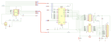

Is there meant to be a capacitor between this pin and.... anywhere else, really (probably GND)? If so, look at that. When you touch the joint you're essentially becoming one plate of a tiny capacitor between that pin and ground: I wonder if that chip for whatever reason wants more capacitance than it's getting.
The various SE/30 schematics all show a single direct connection between SWIM pin 2 and UH7 pin 4. On the other side of the inverter, there's a 33pF capacitor (C67) and I had pulled that one off the board to test it and it checked out. I don't see anything else. Of course, these schematics have had errors in the past.
What's interesting is that there's a schematic specifically for the SE/30 inside the Guide to the Macintosh Family Hardware book (second edition pg 351) and that schematic differs from the Bomarc and other schematics online. The GMFH shows the WR signal going through the RP10 Bourns Filters but the Bomarc and other schematics show the WR signal bypassing it. What I actually see on my board matches Bomarc and the other schematics and does not match GMFH.
Regardless, I also checked the Bourns Filters and they seem ok, resistance checks out, no shorts to ground, etc.
Diagram in GMFH:
In this diagram, the WR from the external floppy DB19 connector goes through a Bourns filter to pin 18 on the internal floppy connector which then goes through an inverter to the SWIM chip.
Bomarc Schematic:
Here you see the WR from the external floppy DB19 connector going through the 22 ohm R30 resistor, meets up with the C67 33pF capacitor (other side is ground), which then goes through the L22 inductor, to pin 16 of UH7 which inverts the signal, which comes out pin 4 and directly goes to pin 2 on the SWIM.
KiKad Schematic (found online):
This schematic I found online matches the Bomarc one.
Reality:
What I see on my board matches the Bomarc and KiKad schematic, not the Apple GFMH book schematic.
