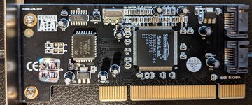

Well, here's the 3112 card I have. Somewhere along the way, I found a thread in another forum with seemingly simple directions AND the firmware and flasher links actually worked (miracle!). So I grabbed them and flashed my Sil3112. Of course, it doesn't work in my Quicksilver. I haven't tried it in my Sawtooth yet, but I'm not going to hold my breath, considering all the physical mods this card seems to require (resistor move & chip replacement). You can see from below that my chip is not one of the supported ones.
So... are there any cards that can simply be flashed - no hardware mods needed?
Other than the original SeriTek cards (and derivatives), probably very few. Almost all of these cheap cards will come with 010 EEPROMs, as they are simply cheaper than 040 EEPROMs, while the PC BIOS will fit just fine on a 010. There is the Wiebetech firmware that will fit on a 010, but this will only work under OS X 10.2 or so and up, so no Classic Mac OS support.
If you want to modify your card, you'd have to change the EEPROM and do the resistor mod. Looking at your card, it's probably the R23 0 ohm resistor besides the voltage regulator that would have to be moved one spot left, to R24. You'd technically not need to reuse the resistor, as it is 0 ohm. A solder bridge between the pads of R24 after the removal of R23 would work just as well.
Several years ago, some of the cheap 3112 cards actually had the Flash chip in a socket, and came with the 3.3V AMD chip that works with the TSATA firmware. We'll probably never get that lucky again.
