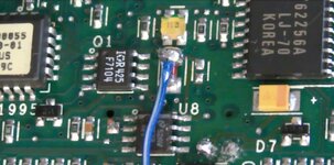

I opened it up -- very brittle plastics, by the way -- and found that the single through-hole electrolytic cap on the board had leaked out the bottom.
I cleaned it all up and replaced the capacitor. The original was a 560 uF 6.3V cap, but I didn't have that exact value on hand. I did have a 470 uF 10V cap though. Ehh, close enough. I'm probably a terrible person for doing that...oh well.
I plugged it in, and it still didn't work! No lights, nothing. So I got out my multimeter and traced things out. The input 12V power from the AC adapter comes into the bottom pin on that connector next to the cap. I tried to find anything else that had continuity with it on either side of the board, but I found nothing.
Taking a bit more time to investigate carefully, I noticed there's a via right under the connector that goes into the input pin of an LM3578A switching regulator (U8). I did more checking to make sure I wasn't confused, but I'm very sure that's where 12V is supposed to go on the board. It's the via just to the bottom right of the 8 in the U8 silkscreen text. The cap goo must have rotted it out on the top side of the board. I can't see it because it's underneath the connector, but I have no other explanation. That via is very close to the cap.
There's no easy way to run a bodge wire from the connector to the other side of the PCB. It's pretty cramped in there. So instead, I de-pinned the 12V input wire from the connector, cut off the crimped pin, brought it out separately to the other side of the PCB, and soldered it to a convenient place where it would have a lot of mechanical support. Don't mind my dirty-looking solder joints on the replaced cap. I fixed them afterward.
Now it works great again. I had to superglue the case shut because of the plastic breaking like crazy inside of it.
