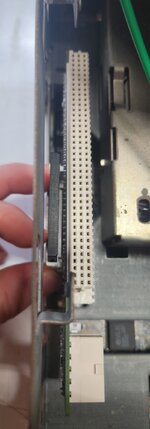

Looks identical to the 030 PDS, so with an electrical adapter it ought to just work as far as the rest of the prototype design is concerned.
@zigzagjoe if someone here or over there comes up with a source for the PDS connector, I've got a small box full of Blackbird bits and pieces headed your way. Bringing those internals to life and put to good use in a test rig chassis will be most entertaining, if and when. ;)
Hope you don't mind this tangent, I'm fascinated by your progress as is. Can't help but imagine the bits on your prototype pic melded with Bolle's NIC equipped SE/30 riser.
I'd be game to give it a shot (of course, need the connector).

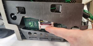

Small suggestion: why not mount the CF holder on an angle so you can access and slide out the CF card while the unit is installed in the chassis?
That angle does allow a straight pull in the IIsi and IIfx, but for SE/30 I couldn't come up with an angle that is any more accessible while being mechanically practical. CF cards seat into that socket firmly and it's not going anywhere without a good grip on it.
I am wondering if this would fit (and work) in the top slot of a riser like @Bolle ’s Ethernet + Carrera slot inside my SE/30
That will be the million dollar question, yeah. With the design I'm thinking it will mechanically fit, and even will fit in conjunction with one of my grayscale cards or LCD cards on top. But if it will work at all will be a wildcard as that's asking a lot of a system originally designed for one add-in card, having a total of 4 at that point. Proof will be in the pudding, I suppose...
Probably worth seeing if the signal is strong enough for a CF extension cable to work. One of those could route it to the back panel.
