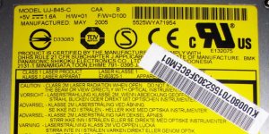

I did a new assembling last night using a supernumerary Pismo DVD-Rom module:
this time it‘s a Matsushita UJ-845-C slot-in burner from a Windows laptop with faceplate. Mac OS X and OS 9 "see" this module as UJ-845-D.  [:O] ]'>
H/W=01  FW=D100 - same as my UJ-845B (S), but this time a got a SLAVE module and so it could‘t boot with the "C" key (emergency boot), but only via Startup-Disk panel etc.
Firmware is okay, but it's a pain in the a** to alter the firmware 2 times on a Windows laptop, until I would get a UJ-845-S Master.

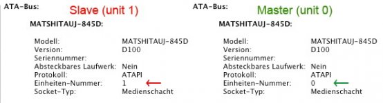

So I took the short way, using the soldering trick from http://www.sterpin.net/uk/dvd8pismouk.htm
This forces the CD/DVD-ROM from slave to master. :D
So I've gotten what I wanted (sorry some german text, but the important text parts are unique):
