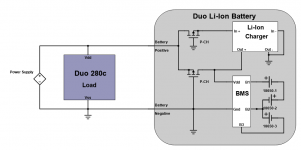

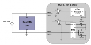

Alright, I promised an update...
The ideal diodes arrived and they work nicely! Under full load, I'm only seeing a ~.2v drop, but (because of course there's a but) I'm still getting low-power alerts from the OS throughout much of the discharge cycle. The OE pack contains 10 NiMH cells in series, which should measure from ~1.5vdc per cell charged to 900mv discharged (15v - 9v overall), and I'd surmised that a Li-Ion replacement outputting 12.6v - 10.5v should fall nicely within that range. I think the problem lies in the fact that NiMH cells spend most of their discharge cycle at ~1.2v, and only drop off rapidly toward .9v at the very end of their useful life. Even with the ideal diodes, under load my Li-Ion pack is measuring in the elevens throughout much of its discharge cycle, which the power manager is interpreting as a mostly discharged battery.
That "but" notwithstanding though, the pack works quite well! E.g., I ran the 280c for a few hours this afternoon with the added draw of an Etherdock and my wifi-module. I'm not really interested in trying to boost the output voltage with more internal electronics since it'd just waste energy, but I wonder if there might be a potential software solution? I suspect the acceptable voltage ranges are flashed onto the ROM or Power Manager (can anyone confirm?), and this passage from the Power Manager Developer Note is particularly interesting:
  • Reading the Status of the Battery and the Battery Charger 6: The Power Manager monitors the voltage level of the internal battery and warns the user when the voltage drops below a threshold value stored in parameter RAM. If the voltage continues to drop and falls below another, lower value stored in parameter RAM, the Power Manager puts the computer into the sleep state. The Power Manager provides a function that allows you to read the state of charge of the battery and the status of the battery charger.
Infuriatingly, neither that Developer Note, nor the Duo's, indicate WHAT those values are, or WHERE they originate from, but I'd bet an extension could override them. There is, for instance, an existing "Type III Battery" extension for Duo type III NiMH packs that ostensibly does something similar to make the OS / Power Manager play nicely with those higher-capacity batteries. I pulled that extension into ResEdit and HEX dumped it, but haven't made heads or tails of the instructions yet. I'd welcome assistance from someone with more experience in that arena than I have. I think all this hypothetical extension would need to do is update the value of "batteryLow" in PRAM to a slightly lower value.
Anyway, that annoying but mostly cosmetic wrinkle aside, here's an updated, accurate circuit diagram and BOM. I've also attached the STLs for any who want to 3D print the enclosure I designed. I printed mine using ABS (Octave's Gray) on my MakerBot 2X with 2 shells at 20% infill.

Have you tried using the Insomnia extension from various Mac OS CD-ROM System Folders? I don't know how it does it, but I know it prevents PowerBooks from sleeping, even if the battery is low.
The way I understand it, the OS via Power Manager references values stored in PRAM (how they get there initially I don't know. OS? ROM?) to determine how it responds to various voltage conditions. After further observation, in the case of my Duo 280c, it warns at 11.4v, indicates the pack is critically low at 11.2v, and goes sleep at 11.0v.
Further reading has suggested that the voltage is measured by an ADC and assigned an 8-bit value, with 0 being the lowest (in this Duo's case, 11.0v), but the scale is apparently fixed (probably defined in ROM). While an extension could modify the warn and critical thresholds values in PRAM (setting both to 0 would, I think, suppress alerts completely), I don't believe the zero point can be moved to allow the laptop to remain on at a voltage below 11.0v.
I've played with a few different extensions, Insomnia included, but it just prevents the notebook from going into a timeout induced sleep (i.e., if configured to sleep after X minutes), but doesn't prevent the Duo from powering off when it reaches 11.0v :/
Without being able to draw below 11.0 volts, I can only access ~50% of the pack's capacity, so I think the only answer from here is an internal boost converter immediately behind D2. I'd really hoped to avoid that because a) complexity, b) inefficiency, and c) the pack output voltage is then fixed vs. variable depending upon capacity remaining. I'll have no indication that pack is nearing depletion until the BMS unceremoniously powers down at LVC. I suppose I could use a variable output boost converter and find a way to reference the output from the input voltage, but still less than ideal...
