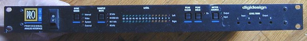

Other interfaces that will work with your SA card are:
DAT I/O (for digital transfers)
and
PRO I/O (A/D and D/A only)
This one is sort of 'super duper' box - analog power supply, Apogee filters, video and word clock sync and so on
Sorry for the fuzzy pictures, they are off of ebone
P.S. I have SA Nubus + PRO I/O myself, if _REALLY_ needed I can take some pics, but that wouldn't be today or tomorrow. I also have SD 2.5 PT, 2.6; 2.6 PT; 2.6 SC and 2.7 in my archives. Sampler support menus (for individual samplers) have been removed after SD 2.6

If you're not going to record or connect your Mac to some outboard gear via digital cable (external DAC, DAT recorder etc.) but all you need is analog output, I can tell you that output circuitry of SAII NuBus and SE/30 cards is identical to that in the A/D box pictured above.
* Same convertors - Analog Devices AD1856 or pin compatible Burr Brown PCM56.
* Same encapsulated Murata low pass filters.
* Same I/V stage ICs - NE5532
* Same red WIMA 1uF capacitors
.......everything..........
All you need is Y-split cable to go from jack to RCA (Cinch).
EDIT - oh, ok, Digi used "audiophile quality" WIMA FKP caps (green boxen) in filters instead of blue NP0 ceramic ones on cards, but that's the only difference.
