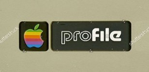

The standard feet on my units here are not even installed.  The feet that are there really look like the ones on my the Apple II series, and even on the bottom of the ProFIle drives and maybe even the Disk II's.  As for the faceplate, I had not noticed that yet.  Interesting input everyone - thank you.  My long torx is on its way.  Hope to have the units opened by the end of the week. Stay Tuned, and keep the input coming - very interesting.
