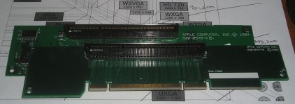

 @trag here are a couple of part numbers and a logo for that 68040 PDS connector. One is on what may be a handy edge card interface for a prototyping board adapter?
D5527 is on a 6100/DOS Card Adapter? H3489 is on a Quadra 610 riser? Add H1573 as the part number on the connector of one of my Quadra 700 boards.
