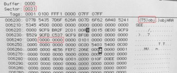

So what you need to do is to use Fedit, a byte-level file/volume editor. After you start the fedit program on your favorite vintage Mac, you should insert the Lisa diskette in question (System 1, or any LisaWrite, LisaList etc....). Your Mac will not recognize the diskette, but if fedit is running, it will ask you if you want to mount it. Go ahead and mount; then go to File>>Open Volume, and click on"drive" until "internal drive" shows up. Internal drive is your Lisa diskette. fedit will then display the first sector of the diskette. What you then need to do is to navigate to the sector number where the serial number is located, using the right arrow (or scroll bar) in the bottom. The first pic below shows sector 31 (in hexadecimal, red box) where this SN is located. For the Lisa 7/7 diskettes, the beginning of this sector always starts with .{Tx}obj (red box), where x is a number associated with the particular program. Here for instance, T5 is for LisaList. The bytes to null out are always the 8 hexadecimal digits in columns 2 and 3, on the 5th row of this sector (red box). Simply enable hexadecimal editing (cmd H), place the cursor over the first of the 8 numbers to null out, then type eight zeros in this location. Once this is done, you need to save the sector to the disk (cmd W), and you're done. I could not find a way to get the floppy to eject in fedit, but after closing it, I found that diskcopy 4.2 would do it, so this is what I do.

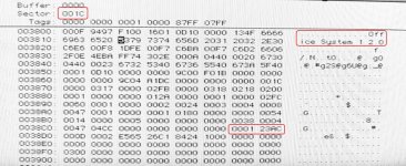

For Lisa System 1, the location of the SN to null out is a bit different (sector 1C, 13th row, bytes 38CC to 38CF - see last pic)

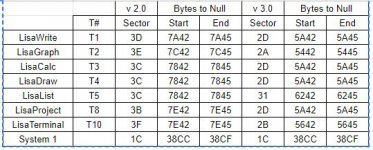

The table below summarizes the sector and byte location for each Lisa 7/7 program (both 2.0 and 3.0 version), as well as Lisa System 1. I hope this helps

Lisa System 1 (v3.0) Diskette before nulling out
