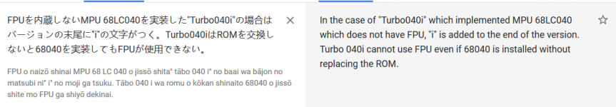

Also, adding to this thread since I happened across this and someone in the future might find it useful as it's relevant to question 2 in the OP. The Artmix site had a page that talked about firmware versions here: https://web.archive.org/web/20070814112501/http://www.artmix.com/romver.html
On that page, they claim that the "040i" version doesn't enable the FPU on a full 040 without a ROM change. I believe that's not correct per my above results.
