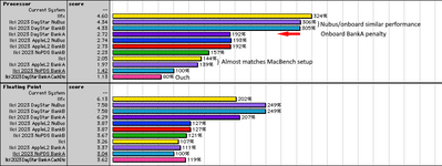

Bingo!
When using a NuBus video card or BankB memory, the DayStar 50 MHz accelerator performed extremely well and met expectations. It measures 3x the CPU performance of a no-L2-Cache IIci and on par with a IIfx. These are the results "This Does Not Compute" was looking for.
Using a smaller disk cache, such that the OS or program runs in Bank A causes contention with onboard video memory accesses. This is the result that "This Does Not Compute" encountered and was disappointed by.
In comparable situations (AppleL2 NuBus vs DayStar NuBus), why is DayStar only 58% (4.34/2.74) faster when the CPU runs twice as fast? Eventually, depending on the benchmark, the CPU is going to hit a memory location that needs to be read from the main memory bus. The 50 MHz CPU is no faster than a 25 MHz CPU if they are both waiting on the same speed of memory. So, double speed is ideal rather than a regular occurrence.
DayStar Cache Off
When using built-in video and with the DayStar cache turned off, the DayStar 50 MHz accelerator cpu performance is indeed horrible. It's 20% slower than a plain IIci. So, clearly the DayStar card fights with internal video for memory access -- which the L2 cache helps alleviate. But, it should still be at least as fast as the stock CPU. Is DayStar disabling the 68030 L1 cache as well? Are they constantly forcing a cache miss or flush in order to disable their cache? I don't know. It should not be this bad.

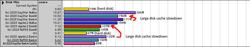

Now let's look at disk performance...
Ignore the "IIfx" and "IIci" because the MacBench testers were using a hard disk back in 1994.
Sizing the disk cache to be too large is rumored to actually slow disk access due to a weak Apple algorithm. For System 7.5, MacBench indeed shows moderately worse performance when using 4 MB instead of 32 KB. Use 256 KB SIMMs in Bank A and 16 MB SIMMs in Bank B if you're concerned. This gives you 64 MB of system/program memory, built-in video, and a reasonable disk cache of 1024 KB to force code into Bank B.

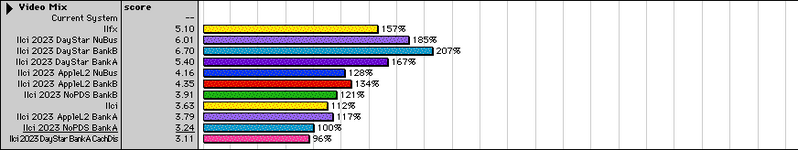

Lastly, video performance...
Nothing shocking here because none of these are hardware accelerated graphics. Basically, a 32KB L2 cache helps somewhat, as does a fast CPU to compute the drawing.

Bingo!
DayStar Cache Off
