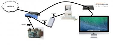

Thank you for not giving up! I think you have to change setup to get this working. This will not work.
Best would be to connect your MacIPpi and AsanteTalk directly with a cable to your LAN. If you have free switch ports on your router you can connect it there. But.... you can also connect it to a separate switch if you have one. Even if you don't would normally use your SE/30 at the same spot as your router, you could test it there if you don't have a switch. If it works you can consider to connect a network cable to a switch from your router. You can pickup a second hand switch at your local thrift shop for 5 to 10 dollar. Buy a 10/100 Mbps switch.
I made  a small drawing.
Mactjaap:
Thank you for the diagram -it really helped to clear things up.
I tried the new setup of connecting the AsantéTalk and Orange Pi to my router's switch, but it made no difference. The SE/30 reported that it was not connected to the internet; however, in this setup, the Orange Pi refuses to report anything when I type nbplkup. It simply gives me an error message. In an effort to troubleshoot, I disconnected and reconnected the power to the AsantéTalk in hopes that it would fix the issues; this changed nothing.
I am stumped at what to try at this point unless there is a Mac related issue.
I hope that I can get this working!
I'd really suggest that you have the AsanteTalk connected to a 10MB ONLY Ethernet hub/switch. The Asante doesn't deal very well with autosensing ports.
On mactjaap's diagram, I'd have had the AsanteTalk connected to a 10MB hub, and that hub connected to the Linksys. The iMac and rPi could be connected to the faster network off of the Linksys. This is the setup that works for me with my AsanteTalk and Localtalk machines.
Not saying mactjaap's wouldn't work, but having the Asante on a dedicated 10MB hub is the only way it works reliably for me.
