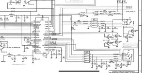

The audio chip on the 575 LB is U1, DFAC-II. Here’s a snippet of the audio circuit on that LB.
Thanks, this is very helpful. I kind of wish the issue was with the AB as that only has a handful of components... Where would you start troubleshooting on this board? Replace the main caps? I've heard of removing the DFAC, cleaning around and re-soldering.
