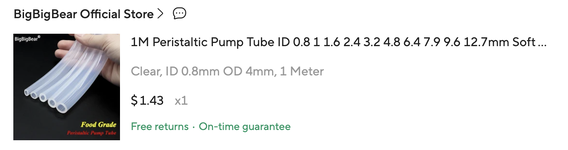

I replace the rollers in every 1xx machine I work on regardless of what they look like. It's cheap and easy. Cleaning them with IPA loosens them up and causes them to spin on the metal shafts. Very very annoying when trying to get the cursor where you want it!
I think that's happened to me once or twice - in those cases, they returned to normal once the IPA had fully evaporated. Either way, there's certainly no harm in replacing them. Where do you source replacements from?
AliExpress - very cheap. Hardest part is getting a straight cut from the long piece.
