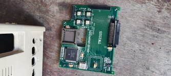

Thank you for the advice and comments, I will check the voltages of both boards with the same symptom and try to revive the new Mac I bought. They say they haven't tested it, but I suspect it has an exploded battery. We'll see what damage it has caused and if I can recover its ROM.

placa externa.jpgThank you, I checked the voltages and got another classic Mac, which has a surprise processor expansion. But I'll change the capacitors on the AB board. In the latter, accidentally measuring voltages, I shorted pins 12 and 5 of the floppy connector and now it only gives me RAM squares, but before I got a sad face of RAM, I think I damaged some component. But I'm soldering on the new board with patience from other boards that also give me RAM squares. I have 3 boards with the same symptom. I hope to be able to fix two, I also have 1 that is in bad shape, from the microprocessor to the battery everything is rusted but the rest is fine. I hope to be able to fix it.
