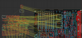

Building an internal grayscale card for the SE/30
Is your existing Backplane Expansion Card adaptable to a 640x480/800x600 VGA converter built into it?
Might you add 600x800 VGA portrait output to the list? will 1024x768 in 1bit or 4bit grayscale fit within available VRAM?
Hmm... I'm wondering if there's enough room on the recreated SE/30 board to remove the B&W circuitry (without the Video ROM the system doesn't even go looking for it) and put this in it's place instead...
:unsure:
It is, but I'd rather keep it DB15 so it will still be easy to wire it up like for like to other graphics cards.
At some point I am limited by how many oscillators I can fit onto the board for all the different pixel clocks.
An option here would be to have a socket for "external monitor" and people would have to put a suitable oscillator in for their desired resolution.
I can tell from experience that even a simple socketed oscillator on an accelerator is going to cause problems to some so I'll most probably not include that as an option. If you want to tinker with weird resolutions warm up your soldering iron :P
It's going to be documented how to calculate and where to put the values in the ROM to set up your own resolutions.
That would fit into the existing 512K VRAM.

Good question, haven’t actually tried the card with anything but 7.1. The driver is sitting in the ROM, no extra system extension is needed.
Switching between internal and external display would require some sort of video signal switch which I don’t plan to implement. The card is going to be wired up in a way that as soon as you connect the CRT neck board wiring harness it will always output compact Mac resolution (or optionally 512*384 if you want that selectable by a jumper on the card)
With the internal harness disconnected it’s going to output 640*480 (or 800*600 - that should still fit into the 512k of VRAM as well)
The video signals are always present on both, the internal connector and the breakout header, at the same time. That’s why it has to be handled in a more restrictive way… neck board connected->always do compact Mac resolution so you won’t fry the analogboard by sending VGA or even 800*600 sync rates to it.
