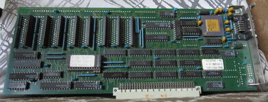

Looking for some divers to the "BMAC PRII 001" Graphiccard. It has a INMOS IMSG300G-10C Transputer GPU Chip on it and 1MB of VRAM. The EPROM Sticker say "PRISMA II v3.1" ...
There are some sites with MIRO driver on the Web but these are wrong for this card. I can not find something ...

Just to avoid searching for the wrong thing: the IMS G300 isn't a transputer, it's a "Color Video Controller" (read: video DAC) and would have made a high-resolution device (max 1280x1024 for some). It was made (designed, rather) by INMOS, and manufacturd by SGS Thomson. So don't expect acceleration on this one, I don't see any chip to do that. And the hardware cursor wasn't usable in MacOS, shame on Apple.
Actual transputers were CPU, and can be found on NuBus, but as parallel acceleration device, not graphic/video.
That's not an accelerated video card, depending on what version of Mac OS they were targeting they may not have even had an extension for it.
Check in the monitors control panel, hold the option key and click the options button. If you see a list of resolutions then no additional software is needed; pick a new resolution, reboot and it ought to change.

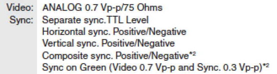

... I test two Monitor a NEC MultiSync LCD1970NX and a MIRO LCD Model 568 but I don't get a picture via the MIRO graphics card.
It do not work without any sync I think?
I think the NEC Multisync supported sync on green but the Display say "no signal". I also use a ijyama or a Miro Display.
