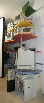

YAY! Another successful battery pull! The Quadra 950 has escaped the curse.
Didn't think I could get it out, but have recovered will enough from rotator cuff surgery to not only to get off workman's comp, but was able to noodle out how to yank it out without disaster or exceeding my restrictions. Pushed the Radius 81/110 almost all the way back in and shimmed up its front shelf standoff far enough to relieve the downward pressure of the 950's standoffs. Worked well enough to get my left arm in there to pull it out from under here . . .
:eek:The bottom shelf rests on those four plastic feets I pulled off somethingorother. The NEC Multispin 6x on top of the clone brings it exactly even with the top of the Quadra. The whole thing is supported by 1/2" threaded rod sections with the big metal can and plastic skyscraper acting as crossbracing. A hex bolt wearing a rubber beanie is hiding behind the leaf and cranked up to the ceiling for further stabilization.
Anyway, everything on/under the Display is now Lithium Baloon free.
