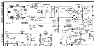

Heres a snippet of the circuit diagram I found in case anyone knows different
