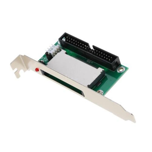

No worries. I do have SD card based solutions, I just as I said, don't have any spare OS7 or even 8 sitting around. And I'm at a loss as to why my ZULUSCSI doesn't seem to boot the garden-available 7.6.1 CD for this model.IDE drives might be a blessing, you can cheaply turn this to solid state. CF cards are basically IDE disks, they just need a passive adapter to get hooked up, something like that:
Best to order different models, they are cheap enough.![]()
IDE ATA 40pin zu Compact Flash CF Adapter Converter w/ PCI Bracket Rückseite GE | eBay
Entdecken Sie IDE ATA 40pin zu Compact Flash CF Adapter Converter w/ PCI Bracket Rückseite GE in der großen Auswahl bei eBay. Kostenlose Lieferung für viele Artikel!www.ebay.de
Small CF cards up to 4GB work best.
