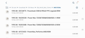

The same ROM was used in a load of similar architecture machines :
There seem to be two versions. Guess they just put two bandits in the structure whatever the host machine was.
Ah, well I guess that explains that. I knew the same ROM was shared by a few systems but I rather stupidly hadn't made the connection that Open Firmware is inside the ROM, so of course it would have a variety of things in it which may be superfluous on certain systems.

Which method did you use to extract the ROM?
I wrote some Forth! It didn't work properly but figuring out how to fix it lead me to a comment of yours made over on the macrumors forums, here. Your code worked like a charm, unsurprisingly.
After getting some help from @tashtari to convert the hex to a binary (spoiler: it was some basic Python) I used the
Code:
diff
command in Mac OS to compare the ROMs. I wonder why it showed the 9500 v1 ROM as a mismatch but the v2 as a match.
I use xxd -p -r to convert hex to binary.
I used the
Code:
diff
The Open Firmware part of the v1 and v2 ROMs are identical. I didn't check which parts are different. You can use https://github.com/elliotnunn/tbxi to extract some other parts and then compare those.
Maybe the S900 was created after the v2 ROM was created so they used the v2 ROM.
