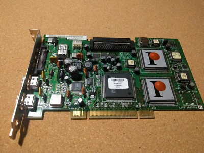

  • Orange Micro OrangeLink FW/USB card, HiNT chipset (image attached)
