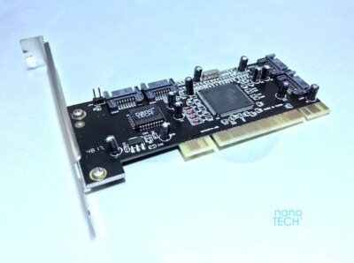

Yeah I just ordered what I assume is a flashed one. 4 port, $50.

I ordered this one. It doesn't say what brand it is, but says it will work with a G4.
We'll see. If it doesn't, I guess I can complain.
