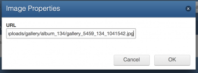

(how do you do it?)
Or you can upload it as an attachment (use the full comment editor from the "More reply options" link below the reply box) and then (optionally) add it into the post.
