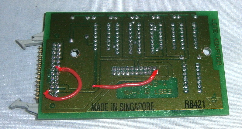

Is it possible to interchange a 2/10 I/O board for a 2/5? This will require use of the same 2/5 motherboard, CPU card and memory boards although the latter 2 I believe are interchangeable between any Lisa system ROMs dependant I suppose if you have the Mac XL screen mod and 800k drive. A source using the Lisa FAQ says it is but the Lite Adapter should see modifications which involve cutting traces. So if I disconnect the Lite Adapter can I do it? Has anybody tried this?
