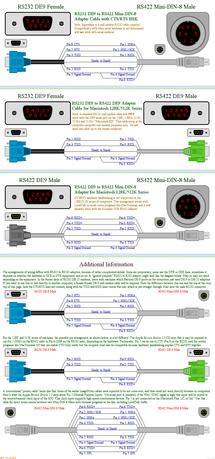

Just what exactly IS an Apple printer cable, and how does the wiring differ from most random eight pin mini DIN cables sold today?
I bought one of those from CablesToGo to connect two old Macs together locally, and it did not work.
A loopback "cable" really isn't a cable. Its a pigtail connector that "loops back" the above pairs in the connector for testing. The Apple printer cable is technically a crossover cable.
An Apple "printer cable" is shown at the bottom of this image.
