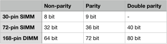

Oh and an FYI to anyone who’s upgrading their RAM on their Mylex DAC960 Raid card it will take up to a 32 MB FPM Parity 72 pin RAM stick. Non-parity EDO didn’t work.
