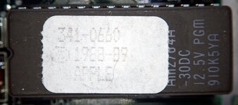

The back of the PCB has the number 820-0185-08. The ROM is 341-0660.

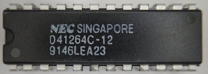

For no good reason, I decided to upgrade the memory on the card. I just couldn't stand to see such wasted potential in the unfulfilled sockets. I ordered new NEC D41264C-12 dual port video DRAM chips from eBay for about $10.
Make sure to install the chips with the notch facing down, not up.

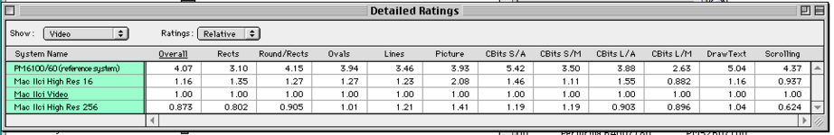

This isn't a particularly speedy card. But, it is period appropriate for a number of old Macs.

Can I ask which tool you used to measure the video card performance and grab that screenshot? Appreciate it.
It's Norton System Info. You have to turn on the detailed view.
