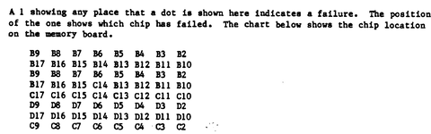

When running the replacement 4116s, I no longer get the "ZP" error during diagnostics, but instead a whole different diagnostic error. Please forgive the gross colour on this one, my test LCD has been hit by lightning in the past and hates Apple II style colour video even if it hadn't been.
I suspect without a working zero page, whatever RAM test algorithm they were using simply did not work well enough to give an accurate picture of the bad chips. I will be using this map to track them down further; at first glance I don't think any of the parts I tested are fingered here.

Can you try to swap chips from the locations found "bad" to other locations to see if the test is relevant or not ?
Unfortunately, there's not all one type of RAM on this card - the "B" row are the gold-plated MK4332 "stacked" RAM. I need to look up the pinout and figure out if I can easily cobble something else together.
That said, I should be able to move them around and see if the error follows the IC.
D17 was another bad 4116 and was replaced, which made that error go away. Now Confidence Program thinks I'm a 64K Apple III (but still gives up almost instantly on the RAM test.)
Probably giving up because the lower bank of memory is required to keep on going. So more chips should be bad.
