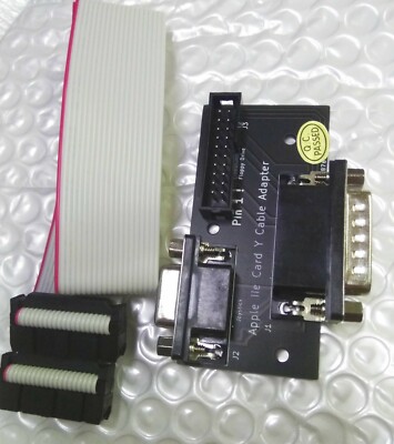

I see the cards on eBay but none of them have the cable or what ever is supposed to connect to the port. What is supposed to connect to that port.
It’s commonly called the “Y-Cable”. The card has all of the pins for a joystick and a floppy port. The Y-Cable breaks them out into separate DE-9 and DB-19 connectors. You can find cheaper replacements for the Y-cable online, depending on what you want to plug in (Apple joystick or none; Apple floppy or Floppy Emu or none).
Do i need the cable or does the card's software allow for mounting of disk images? I just don't understand why someone would command such a high price for a card if you cannot use it without the cable
You don’t need the cable to use the card. I don’t think there is any real reason the cables are expensive, beyond the fact that they seem rarer than the cards (people toss unusual cables all the time; less so installed expansion cards).
I don’t think you can use disk images, but you can use the computer’s mouse and floppy drive, and you can put ProDOS partitions on the computer’s hard drive. As far as I know, then only case in which the Y-Cable (or a replacement) is strictly necessary is for the joystick.
I am thinking of buying the E card and if have the pin out of sockets you could make your own if you are up to soldering.
Yes, you don't need the cable except if you need to have a joystick plugged in or a 5.25 drive with related software.
Wouldn’t that be the main purpose of playing IIe games (a joystick)? That would mean it’s more required than what’s alluded to.
