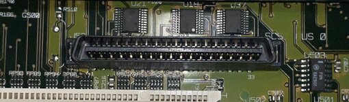

Anyone happen to know where one could obtain the proper cables for the ANS 500/700 SCSI raid card. It appears to be a 68 pin scsi ultra connection. But the connector on the main logic board appears to be a small 68 pin female centronics type. Is this even available? The connector on the Mylex Raid card is a standard 68 pin female.

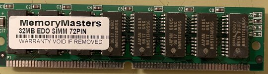

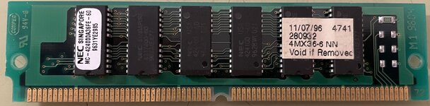

Hey gang no ideas on this cable?? I also am trying to figure out the proper RAM module for the RAID card. Specs say a standard 72 pin SIMM up to 32MB. I’ve tried one that’s EDO.. won’t work.. so what do I need?? Parity or non parity???
The First photo is the original that works.. the second is the 32MB EDO.. so I’m assuming I need a non EDO??
This is the end piece I need going to a 68 pin male. Do these cables exist??

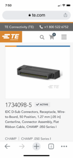

So these are the cables that are needed if you add a Mylex Raid Card to the ANS… I’m having trouble finding them. I guess it’s a SCA68 female to HD68 Male. Here’s what they look like

Jajan547, yup I ordered those.. a little worried as they say “twisted pairs” in the description. I’ll see if they in fact work.. I’ll let everyone know..
Well it worked!!! I have a DAC960 PCI Raid card working flawlessly inside an ANS 500! So if anyone tries to do this you need to get the proper DAC960 board with 2 channels and should include the battery board (which I have disabled through the utility). There are many DAC960 versions but you need the correct version. Once you get a hold of the right board you need to get a new firmware EEPROM chip and install it. The actual most difficult part of this process was finding the proper 68 pin internal scsi ribbon cables.
