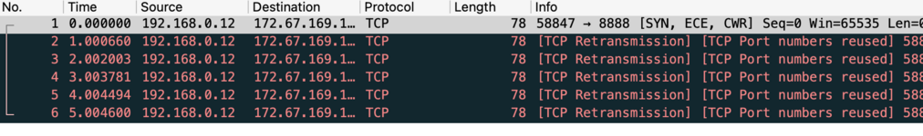

Yes, going through your cloudflare setup, I don't even get an ACK back from the SE/30:

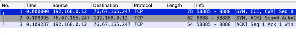

Whereas I do get an ACK back immediately when short-circuiting it via the direct IP:
This almost certainly isn't a DNS problem (at least not straightforwardly) - definitely look at your cloudflare setup.

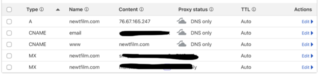

I used another one of my domain names, http://newtfilm.com:8888 and in cloudflare I put it in development mode (supposed to bypass cloudflare's servers). Here's a photo of my DNS settings:
Not too much there. I wonder if I am not completely understanding how to set up hostnames in the WebStar setup:
