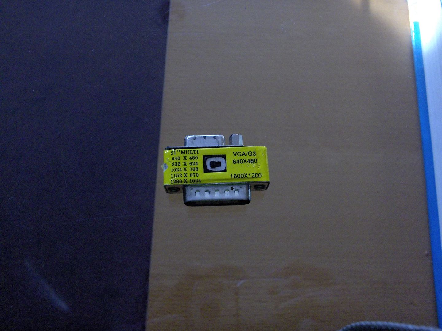

This is what I have:
LINK
Works great, no complaints. Got it for 99 cents on ebay.
LINK

I believe so, but I haven't tried. I use it at the max resolution.
