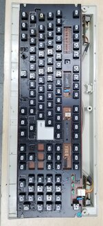

Cutting Edge (Really OEMMAX): Retrobrited, came out nice. Keys were almost orange, still retrobriting. Replaced both ADB ports. Board corroded, was sitting in water for a while like above. Also degreased and washed, because I had nothing to lose. Keyboard does not work reliably now that the ports are replaced. Once plugged in, all three LEDs stay lit, keys do not register. It did this before the wash too. Guessing some component is toast. Any ideas on how to further proceed with this one? Would really like to get it going.
Here are some photos. I can do any soldering required on these since it is all thru hole simple stuff. Not sure how to find replacements, never had to do this before. The large chip was getting somewhat warmish while plugged in for a minute.

I -know- this is not the right way to check, but I tested the two radial caps with my multimeter. One cap, by the power connector, tests that its working at least partially, as the meter slowly climbs up as it charges. The meter stays at 1 with the other cap, as if I didn't test anything at all. They were left in circuit. Again, know its not correct really to do this, other than to check if they do anything. Am I correct in my thinking that this cap is bad?
Replaced both caps. Nothing changed. Ideas on where to go next? I don't mind replacing all the components to just rule everything out, there aren't many (besides resistors). Just don't know the modern equivalents. Unless someone thinks something shorted out?
I know it would stink….but that IC could also be toastz
As long as I could find a new equivalent, I wouldn't mind. How does one even look for a new one? I have tried typing in the numbers online and nothing comes up. Guessing it would be the main controller, the big one?
