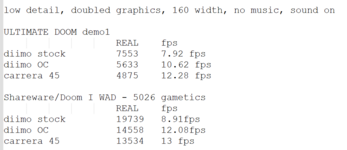

Here's some more benchmarks of interest. Background: I've got a couple of unique socketted accelerators I've created and I've been exploring performance with them.
This is a clone of the DiimoCache 030 I made. As always, massive thanks to Bolle for his reverse engineering effort.
CPU runs at 58mhz (rather than 50), FPU also at 58mhz (compared to 25mhz), and it has 128KB of cache (64kb stock).
This is a clone of the Carrera 040. CPU running at 45mhz rather than 40, with the onboard 128KB cache working.
Doom timedemo: apparently very limited by bus access.
Note: "carrera 45" has external cache disabled, and internal in write-through mode. "45 wb" has internal 68040 cache in write-back mode, "wb+cache" has both caches. "slow" has a non-optimal clock phase change that slows memory access.
I am trying to get together some real world benchmarks (compiling code, compression, doom, etc) together to assauge my curiosity. So far System Info's detail CPU performace seems to give the most specific detail into CPU performance. Some interesting tidbits have come out of the mix....
  1. Additional cache on the Diimo 030 helped Doom quite a bit, more than just the raw clock speed increase explains.
  2. 68040 accelerators are very slow at accessing the main system bus, where 68030 accelerators are much faster.
    1. Bolle was able to confirm this behavior on both his Carrera and Daystar 040, as well as a Powercache 030 to compare to.
    2. Powercache 030 and Diimo have similar bus access characteristics - almost 2x as fast as an 040. The 040 is essentially no faster than the original 16mhz 68030 at accessing the bus.
    3. This results in slow video performance since the 040 can't update video memory quickly. Drawing primitives (lines, etc) is faster since that's limited by the CPU, but block copies (copying a picture from main memory, for example) are slow. Basically, not any faster than the original 030.
    4. So this answers why 030 accelerators with cache feel more responsive than 040s: Faster UI.
  3. Interesting regression: 68040 accelerator w/ both caches (write-back cache and external cache) is slower at memory access than a 68040 with no cache/internal cache in write-through mode
    1. Caches otherwise massively increases performance (as expected).
    2. However, when accessing (presumably writing) to main memory, the caches slow things down.
    3. This is counter to expectations: if anything, one would expect writes to be faster with the write back cache enabled.
  4. Speedometer is not a good overall test of a system. Macbench and System info are both better.
  5. Diimo uses around 5 watts additional (idle), Carrera uses around 8 watts (idle).

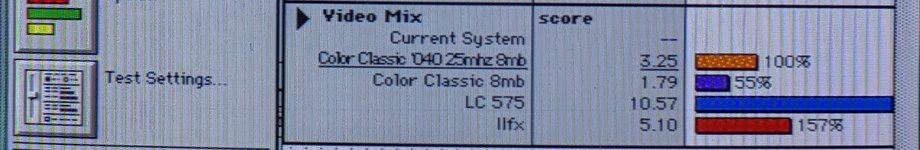

Here are some MacBench 2.0 benchmarks of my Color Classic with a Sonnet Presto LC 040 accelerator. This is not the Presto Plus, so there is no RAM on the card. This causes a significant bottle neck since the '040 is accessing the RAM through the 16 bit data bus. I compared the accelerated CC against the same machine without the accelerator (8mb RAM for both tests). The machine is running at the stock resolution, it has not been modded for 640x480. I also added a LC 575 from the included results since this should accurately represent a Mystic mod. And an IIfx for fun. Not surprisingly, the Presto accelerator is much faster than the stock CC, and considerably slower than the LC 575.
Edit: this is the version of the Presto with a full 68040, not the sans-FPU 68LC040, this difference is apparent in the floating point tests vs. the LC 575.
Click thumbnails for larger images.
