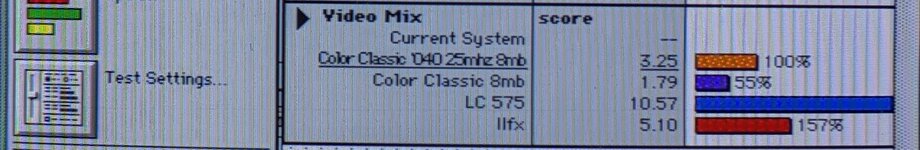

I ran some benchmarks with MacBench 2.0 with and without the accelerator and compared them to the included LC575 (Mystic) and IIfx. Not surprisingly it is much faster than the stock Color Classic, and much slower than the Mystic. The 16 bit data bus really hurts performance. It does however make the machine plenty fast for regular use, it definitely does not feel slow.
