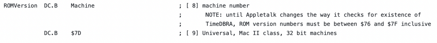

Turns out, the patch loaded depends on the ROM. Specifically, the two bytes after the dot in the name correspond to the two bytes at offset 8 of the ROM, which are a ROM version consisting of apparently the machine number and some kind of machine class?
The IIcx ROM has 0178 in this location, which means that the first patch file will be loaded. The Quadra 650 ROM has 067C, which means the second will be.

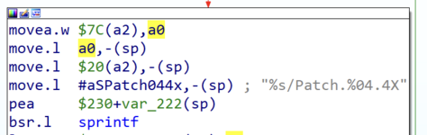

Much of these startmac binaries are, unsurprisingly, black magic. But usefully, debugging symbols were left in, including a suspicious looking routine called getPatches. getPatches uses good old sprintf to generate the path to the patch file:
A2 at this point points to the middle of a big struct for which we have, irritatingly, no field names. But a quick look for other points where offset $7C is written to takes us into a function called getROMImage. getROMImage does some shared memory shenanigans I do not properly understand to convince the kernel to hand over a copy of the ROM. But at the bottom, we find this:
