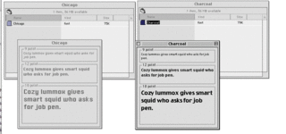

This got weirder... so the machine had 8.5 installed, the CD's I booted from were 8.1 and 9.0.4, no text with those. But I was playing with a new RaSCSI which had a volume with a 7.5 version, booted from that version and text was shown!!! Everything looked ok. I was happy, then upgraded to 7.6, no more text.
When booting from 8.5 I couldn't open the hard drive folder, it didn't show, but when I booted from 7.5, I checked the internal drive 8.5 system folder, Chicago rendered just fine, Charcoal font was missing though. But in 7.5 I could find Charcoal either.

Charcoal wasn't used in System 7 so it isn't expected to be there. It should be there for 8 and up though.
