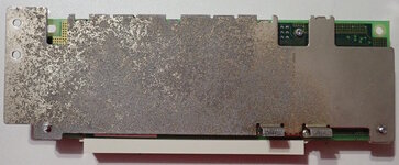

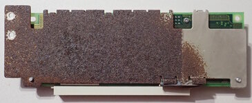

RUST
Although the rust is deep, it has not compromised the mechanical integrity of the screws or panels. So, the goal is to remove the surface rust and prevent further damage. I don't need the results to be aesthetically pleasing. I used Evaporust and electrolysis, followed by a coating of Boeshield (a slightly waxy treatment).
The screws cleaned up nicely, although some rust returned on the edges.
Although the cleaned bracket edge is pitted, I am content with the results.
I had very low expectations for the side shielding.
Although unattractive, it is solid. The dark areas have been converted to a non-invasive iron-oxide molecule.

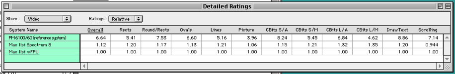

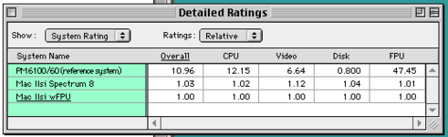

Let's see how the cleaned up video card performs, along with an FPU in the PDS adapter socket.
The Spectrum 8 line (below) is the SuperMac card in the SuperMac adapter with an FPU. The "Mac IIsi wFPU" line is standard internal video with an Apple NuBus adapter card with soldered-on FPU. The socketed FPU works in the SuperMac card, as the results are identical to the NuBus card.
The SuperMac video results are slightly better than onboard video.
