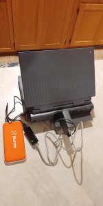

I have a few of the older Asante EN/SC adapters including one for the Powerbook that I've used with various 170's and 180's over the years.  I routinely use the Micro EN/SC connected by a short ethernet cable to a little IOGear Ethernet->WIFI dongle which is in turn powered by a USB cable connected to a small battery pack.  It looks a little silly but I wind up with a fully cable-free (or at least untethered) Powerbook 180 experience with network connectivity to the netatalk AppleShare Linux box in the basement.
