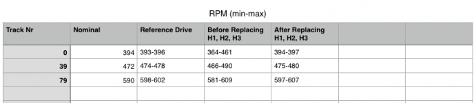

Diagnostic "sonytest" is indicating what seems to be a clear sign that something is not ok with the control signal: for track 00 nominal rotational speed should be 390 rpm, up to 600 rpm for track 79. A working drive is actually reading something within the tolerance (e.g 393 - 395 rpm for track 00 and 595 - 597 for track 79), whereas the faulty drive is reading strongly fluctuating values: 364 - 461 rpm for track 00 and 581 - 609 rpm for track 79. So, I assume something is NOK with the PCB or with the motor board...

Quick update for those who are still interested in this topic.
The main PCB is definitely not the failed component, there must be something wrong with the motor board, as replacing it with a spare one gives a perfectly functional 100% error free disc drive.
395-396 rpm at track 0, 600-603 rpm at track 79. First take away: think twice before replacing the capacitors in a faulty drive, as chances are good that they are still OK.
In a similar thread in the forums from MacRumors, they highlight that some units developed speed control related issues due to aged out hall effect sensors.
Will try to give a look into them as soon as I find some time.
Check done on all capacitors of the motor board, all of them in perfect shape, within +/- 10% tolerance (test done off circuit).

Hi Guys,
some updates from my side. Eventually, it seems as though it was indeed the hall effect sensors responsible for the abnormal rpm fluctuation.
I replaced the three of them at once, so I can't tell which one exactly was faulty.
RPM are now stable and within the range (slightly above nominal, but perfectly aligned with a tested working internal drive).
Curious thing to be noted. Soon after replacing the sensors, the drive had an unstable behaviour, with the rotational speed fluctuating and generally drifting towards high RPM. At a certain point the drive spun up above 2000 rpm!
A quick check to the available service manual "Sony OA-D32 Microfloppy Service Nov83" at page 50 suggested that in case of motor speed "abnormally high" the first fix to try is re-soldering some connector. In fact, while trying it, I could realise that the connector was not properly seated.
Anyhow, I will now try to replace the capacitors to see the influence on the range of fluctuation.
