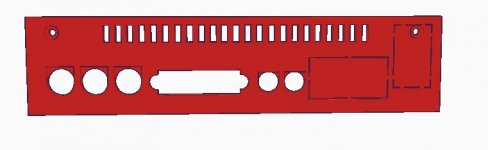

Oh... I gotta get back into CAD and build up an STL for a port replicator for the Pismo with readily available cables/connections on fleabay.
I'll get something going over Christmas break.
If you need one to model for the project, I've got the BookEndz/Pismo in hand. It's a bit large to print out of whole cloth, but doing the dirty on the back end mounted to laser-cut clear plexi docking sled bits would work great.
