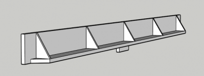

View attachment LaserWriter Paper Stop.stl.zip
Made a stopper plate for the original LaserWriter / Plus paper cassette (works in letter/A4 cassette and legal cassette.)  I got a legal paper cassette for my LaserWriter, but it was missing the stop plate for the smaller page sizes.  So I managed to track down the apparently only image of one from an eBay listing, and used that as a reference image.  Then created a new one in Sketchup.  Printed it out on a Dremel 3D printer.
Reference:
3D image:
Stopper in action:
