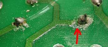

Someone replaced the X-class capacitor C38, but not the other RIFAs? (I have now done so)
Looking underneath that capacitor, does the soldering on the right side look suspicious to you?
The pad is missing! (Repaired by scraping the mask off the nearby trace and looping wire from the trace to the component lead.)
