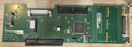

The Storage Dimensions DataCannon/PDS is an 040 PDS SCSI card. Mine has the version 1.1 ROM (attached below). Mine also had the Storage Dimensions stickers torn off (before I had it) revealing the name of the presumed actual manufacturer of the board, "Tech Noir". Because the forum search isn't very smart, I'm going to also say TechNoir here without the space to assist people in finding it.

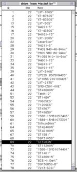

I'm using MacinStor 3.1.4, from the Garden. To work out which disks it supports, I looked at the 'driv' resources in the MacinStor application, which all conveniently have names:
I chose the Seagate ST3283N totally at random and told a ZuluSCSI to present itself as that. You probably want to resist the urge to click 'Initialise' - when I did that it froze - and instead use the Auto Setup function to set up partitions.
After I did this, the drive appeared on the desktop with a cannon icon, and this now mounts every startup.

Further notes:
  1. The drive type check is only done while initialising, the driver doesn't care.
  2. Adding an extra 'driv' resource doesn't magically make it supported. There's probably something more complicated going on that I don't currently have the energy or will to dissect
  3. This is a deeply impractical card to have in a Q700.
My guess is because it’s a full length card and probably barely fits in the Q700 case?
Yes - full length card and the 040 slot in the 700 is the bottom slot. So the card has to run over or around the next-to-bottom card if you have one installed, then all the way across the case somehow without knackering the airflow and into the drive cage.
And the SCSI connector is on the top edge of the card, so as you say @lobust it gets caught between the lid and whatever else is under it very easily. Designed for a rather larger case, I think.

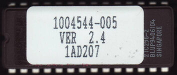

Also thanks @cheesestraws for pointing me to this listing for a Data Cannon ROM v2.4 upgrade kit which also included MacinStor v3.2.5.
https://www.ebay.com/itm/354631040717
All of the contents are attached. ROM on a TMS27C256.
(mirror of eBay auction photos)
s-l1600-1.pngs-l1600-2.pngs-l1600-3.pngs-l1600-4.pngs-l1600-5.pngs-l1600-6.pngs-l1600-7.png
