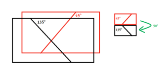

the rear polarizer must polarized 90° greater than the front. generally that means that the front polarizer is 45° or 135° and the rear is 135° or 34°.
artist's impression:
black = front polarizer, red = rear polarizer

finkmac
finkmac
the vinegar syndrome patterns actually reveal the polarizer degree. in your case the front polarizer is 45° and the rear is 135°
