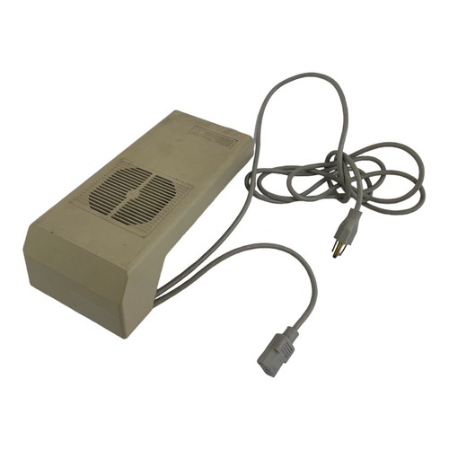

There were a number of 3rd-party fan attachments that go over the top of the Mac 128k/512k/Plus. Probably the most well-known is the Kensington System Saver, though there were many others. (There was a version of the System Saver for the Mac SE, but that one is just power management, no fan, as well as versions for the Apple II, but those aren't of any use on a Mac.) Additional ones included: Mac'N Frost, MacBCool, MacFan, MaxChill, Fanny Mac, and probably others.
The problem is getting one for a semi-reasonable price. People have decided these are "valuable" I guess, and charge anywhere from $50-100 for one on eBay. You may just want to go the route of hot-gluing a regular box fan inside the case and using hook leads to connect it to voltage and ground. Larry Pina talks about it in the Macintosh Repair & Upgrade Secrets book.
if you want to keep it cool, you could rig up an ersatz System Saver with some kind of sturdy cardboard box and a large, slow-moving fan, perhaps with its own mains cable, so you wouldn't need to solder anything. Make sure it's drawing air out of the top vents, not trying to push it in.
If you want to Do Science™, I think someone made a cardboard net for a MacChimney available. Those are kind of bonkers, but they ought to work. I've never built one or measured the actual temperature difference though. You could provide data for The Good Of Humankind (for a fairly restricted definition of the good of humankind)
